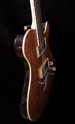

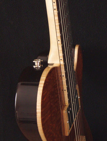

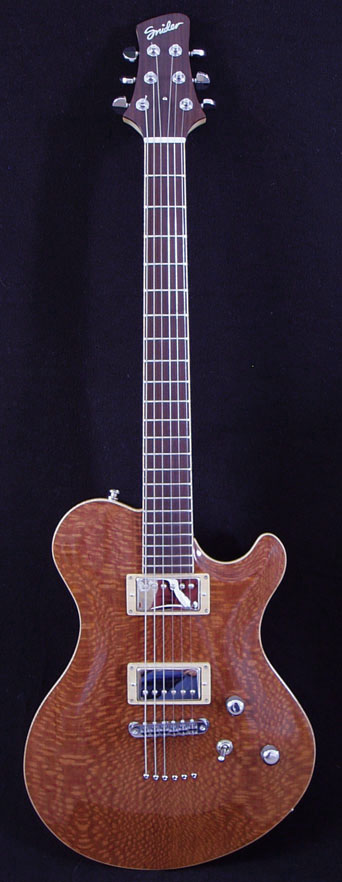

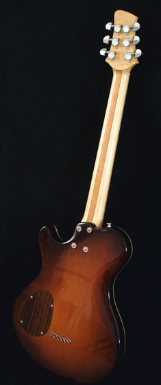

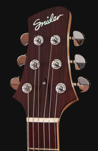

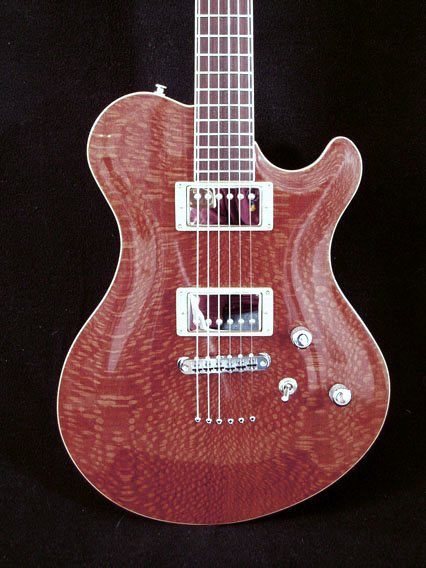

Just finished up this one. It was the "demo" I built along with my
students. Lacewood and alder body, with curly maple binding and pup
rings. Maple and cherry neck, EIR fb. Polyurethane finish on the bod, tru
oil on the neck, which I'm loving. Special thanks to Dave White for all his
tips on that.
Thanks fer lookin.
